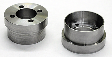

Advance Manufacturing implemented a Mori Seiki NZX2000T3Y3 in its shop—a dual spindle, multitasking machine, with Y axis on all three turrets—to get more parts through the shop for a large order from an X-ray machine manufacturer. The parts were simple, made of core iron (a relatively soft material), but the order was for 10,000 pieces, annually. The company had been making the parts with single-turret Mori-Seiki NL lathes, knowing that a multitasking machine could reduce the 9.5-minute cycle time by a good margin.

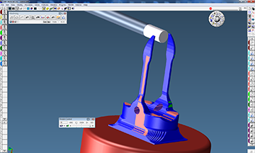

GibbsCAM Cut Part Rendering (CPR) verifies toolpath, both in process, and after programming is complete, showing different operations in different colors, as the user chooses. This rotated view shows the 4-axis toolpath as it machines a medical clamp.

Today, GibbsCAM MTM’s Sync Manager assists in programming and managing multiple tool groups—turrets in this case. To achieve the highest efficiency in production, the part program must be balanced so that the majority of the work doesn’t fall on a single turret while the others wait. Ideally, all tool groups would work simultaneously for exactly the same amount of time. Balancing can be difficult to achieve, especially for parts that require multiple operations with each turret.
High speed roughing was programmed with GibbsCAM VoluMill for 3-axis machining, while surface contouring and finishing was programmed with GibbsCAM 5-Axis for 4-axis simultaneous machining.
“GibbsCAM takes care of three turrets very easily—syncs them all up, and it spits out all the wait codes. So we use Sync Manager a lot, every time we program that machine,” Mr. Barton explains. “We have seen cycle time reductions between 50 percent and 75 percent on the machine. The NL lathes also have dual spindles, but a single turret. It was having additional turrets and a good way to manage them that sped up the job.”
GibbsCAM MTM’s Sync Manager, like the machine control, treats each tool group individually, generating a different program for each. It shows the operations for each turret side by side, with wait codes (sync codes) to prevent tool interference and collision. It allows the programmer to move operations from one turret to another, and to reorganize operations, to balance the program, using visual markers and alerts for the programmer, to ensure that no interfering motion is programmed.

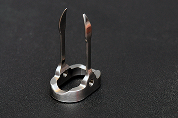

Now that they have the five-axis software, Mr. Barton uses it for many other complex parts. One example is an eight-piece medical prototype order the shop completed recently. Made from 316 stainless steel, the part is a clamp, approximately 1.75 inches × 1.00 inch × 0.75 inch, with two thin prongs. Because there would be heavy machining forces, to prevent rotation in the fourth-axis chuck, each piece was prepared by machining a hexagonal boss. Roughing was programmed with GibbsCAM VoluMill, which generates a high speed toolpath that maximizes material removal while minimizing tool wear.

The Mori-Seiki NZX was acquired to make a considerable reduction in the cycle time on this core iron component, a goal Advance Manufacturing Technology achieved with assistance of GibbsCAM MTM software.
