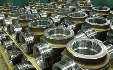

Examples of parts made by BRC

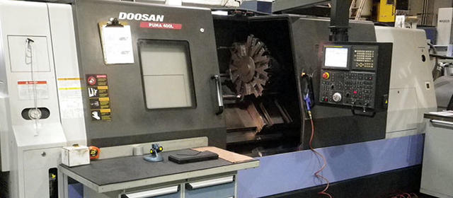

One of BRC’s new Doosan machines on the company’s shop floor in Calgary.

In the last few years, the company has been getting requests to do larger pieces - completion and artificial lift components for the oil and gas industry. Most of the BRC shop is focused on small to medium part machining, so to meet these new demands the company acquired a Doosan PUMA 400LB, which has a 4.5-in. through spindle bore, 15 in. chuck bar capacity, a two metre bed, and high pressure 1,000 psi coolant for deep drilling.

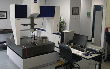

BRC’s new Zeiss Accura scanning CMM.
“That machine got so booked up so quickly that we next had to get a big brother for that machine – the PUMA 400 LMC, which is the same length as the LB, but has a larger spindle bore (6.5 in.), and therefore a bigger chuck. We also opted to get it with live tooling, so it allows us to do some tubular components in one setup.”
The most recent BRC investment is a new Zeiss Accura scanning CMM they purchased early last year.
“We were getting into some very high-end reservoir exploration parts made of Inconel with 0.002 true position tolerances, and our customer was telling us about non-conforming parts we hadn’t caught,” says Carter. “We felt that if we wanted to keep pursuing this kind of work, we had to be able to measure it better than we were.”
The Zeiss has software with the power and ease of use that BRC was looking for. “It has an excellent reputation as a quality product, and we can use customer-supplied programs on it as well, which is a real bonus,” says Carter.
